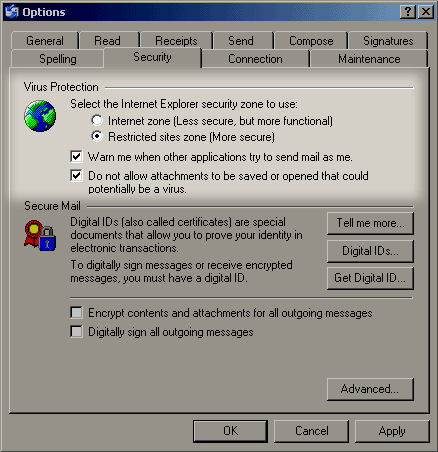

Microsoft Outlook Express
SECURITY WARNING: Due to the regular, severe security problems with Outlook and Outlook Express, we highly recommend using a different email program. Consider trying a 3rd-party email program, such as Mozilla Thunderbird (web browser) or Mozilla Suite (a web, email, newsgroups, and IRC suite).
If you use Outlook Express (OE), and are not using version 6 (available in Internet Explorer 6), we highly recommend upgrading now. Once you have finished that, please come back here and continue securing OE.
Newer versions of OE offer some added protection against viruses. One setting causes HTML email to be opened in a restricted environment (preventing things like JavaScript from running in an email). Another setting makes OE prompt you if a program is trying to send email in the background using OE (a common virus exploit). And the third setting allows you to block access to executable attachments (this feature is available only in OE 6 and later).
To turn these features on, open OE and select the "Tools" menu. Then select the "Options..." menu item. Select the "Security" tab, and you should see these options in the Virus Protection area:
